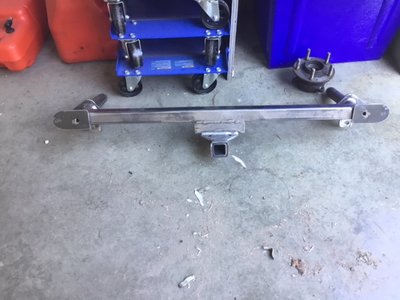

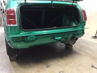

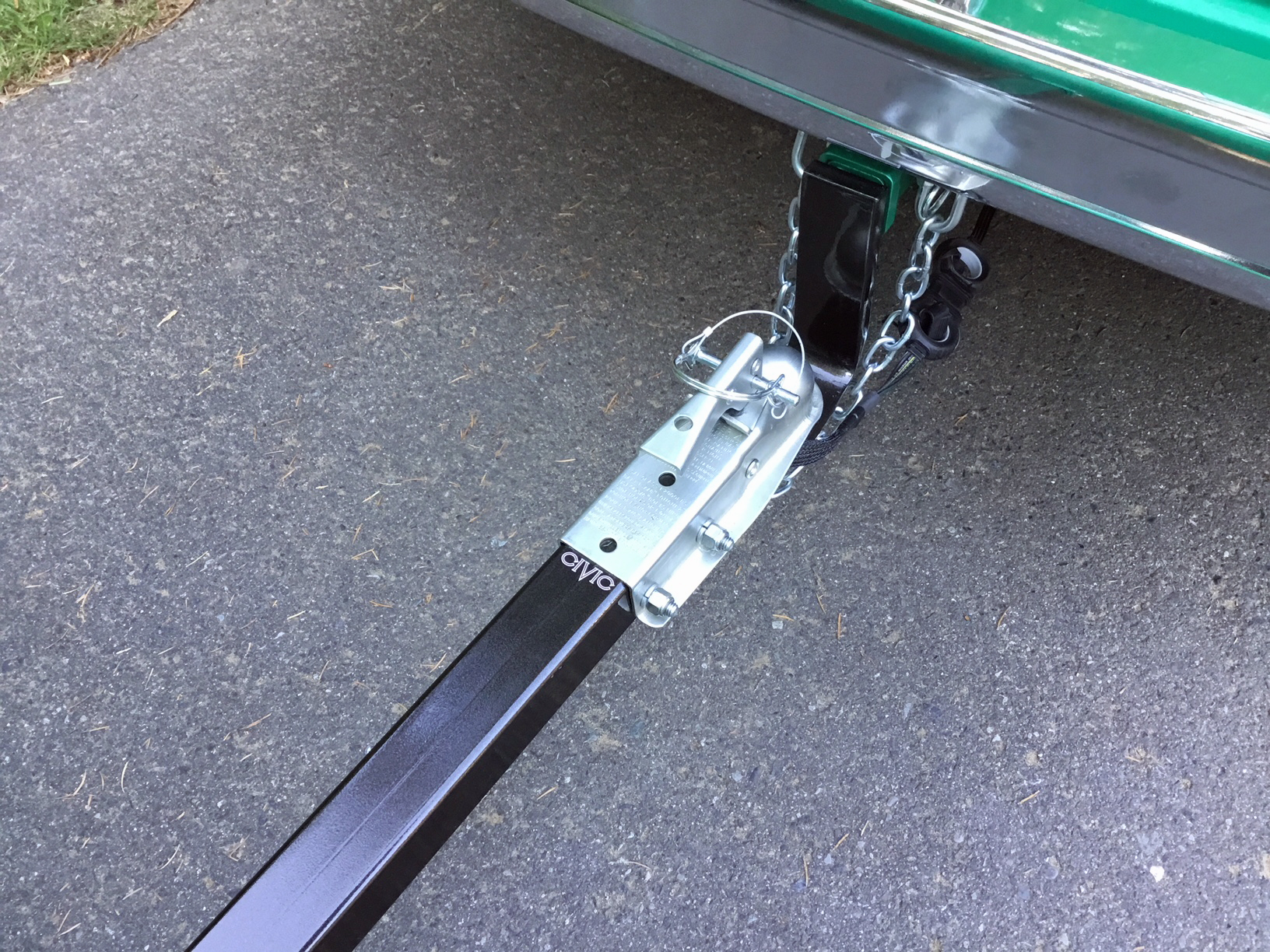

Kinda. My car is a '78 despite the earlier bumpers so I have retained the bumper shocks the 78-79 cars used. At this point, I have them removed but, there are 'tow hooks' attached to each of the bumper shock mounts (see pic below).
My thought was to weld a beam across these tow hooks and weld in the small small receiver to that (like the 'Curt' brand Toyoto Corolla one below). BUT, for extra support (and peace of mind) I was thinking of then welding in another support beam that curls underneath the car and bolts onto a plate I would weld or bolt to the part where the tow hook is behind the spare tire well.
I want the entire receiver assembly to be removable which I could do by removing those bolt one tow hooks and from the plate underneath the car as I don't want to stare at the hitch assembly when I only plan on towing the trailer once or twice in a season. My main concern is making it all safe so I am using previous set ups like Twylas (Justins), Vic's and Will's to see what has worked....they have towed their trailers a lot and I can attest Twyla's has been loaded up good and heavy on our annual 1000 km round trip.
I am new to welding (as you can see in the pics!) so I am having Jay (a previous first gen owner) who is a welder by trade design, fabricate and weld up the trailer frame and hitch.....I kinda want it to stay attached to the car :mrgreen:
