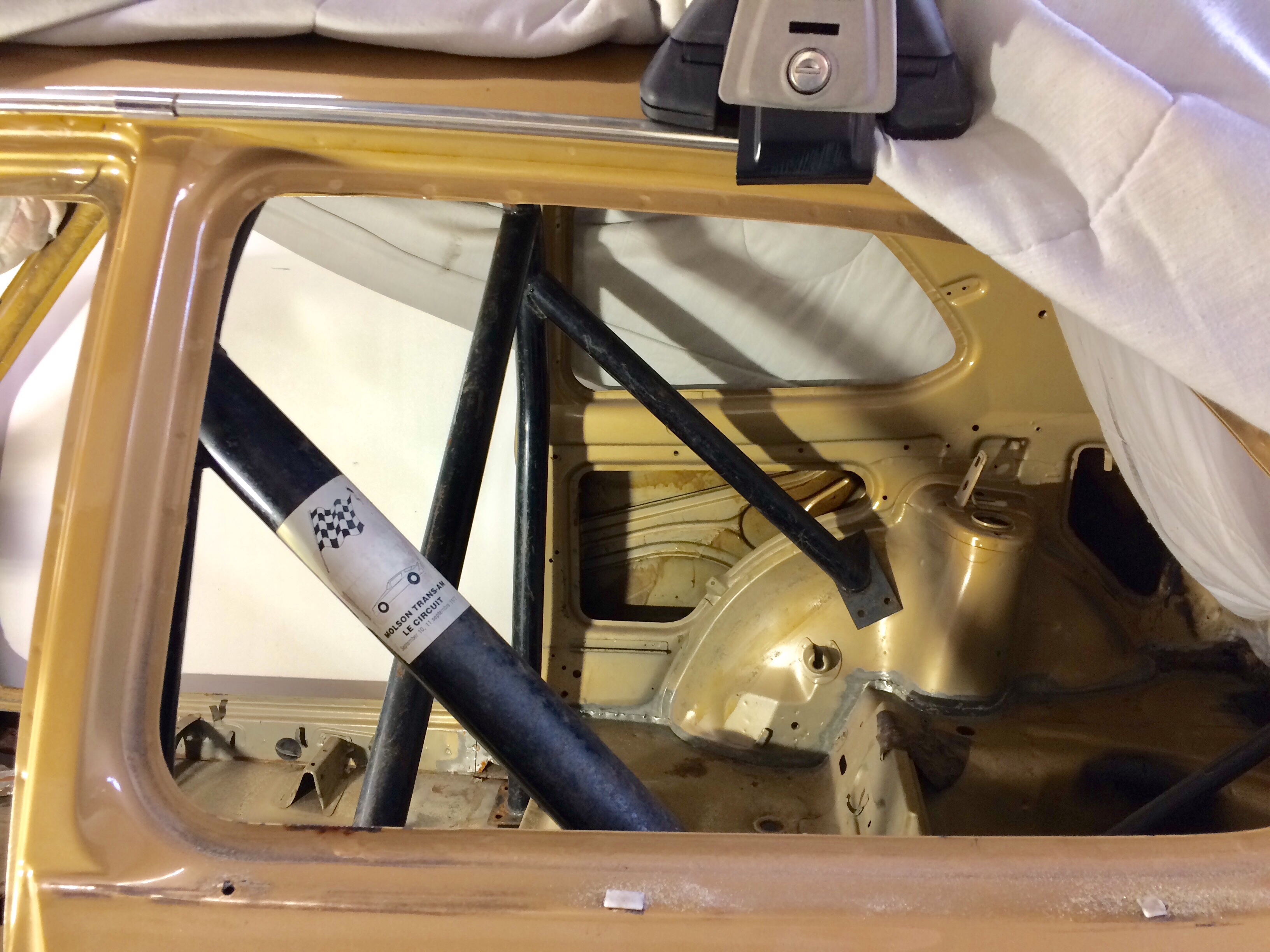

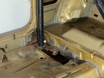

During some of the worst ones my loving 🥰 wife drove me to pick up this nice addition to the project and with the help of Bruce was able to get it in the back of my wife’s Honda Fit. I cannot drive at this time.

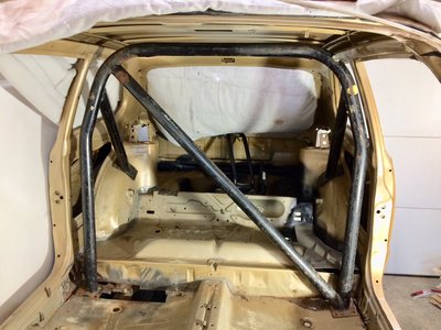

That roll cage looks fantastic. And nos even!! Never seen a piece like that before so what a find!!

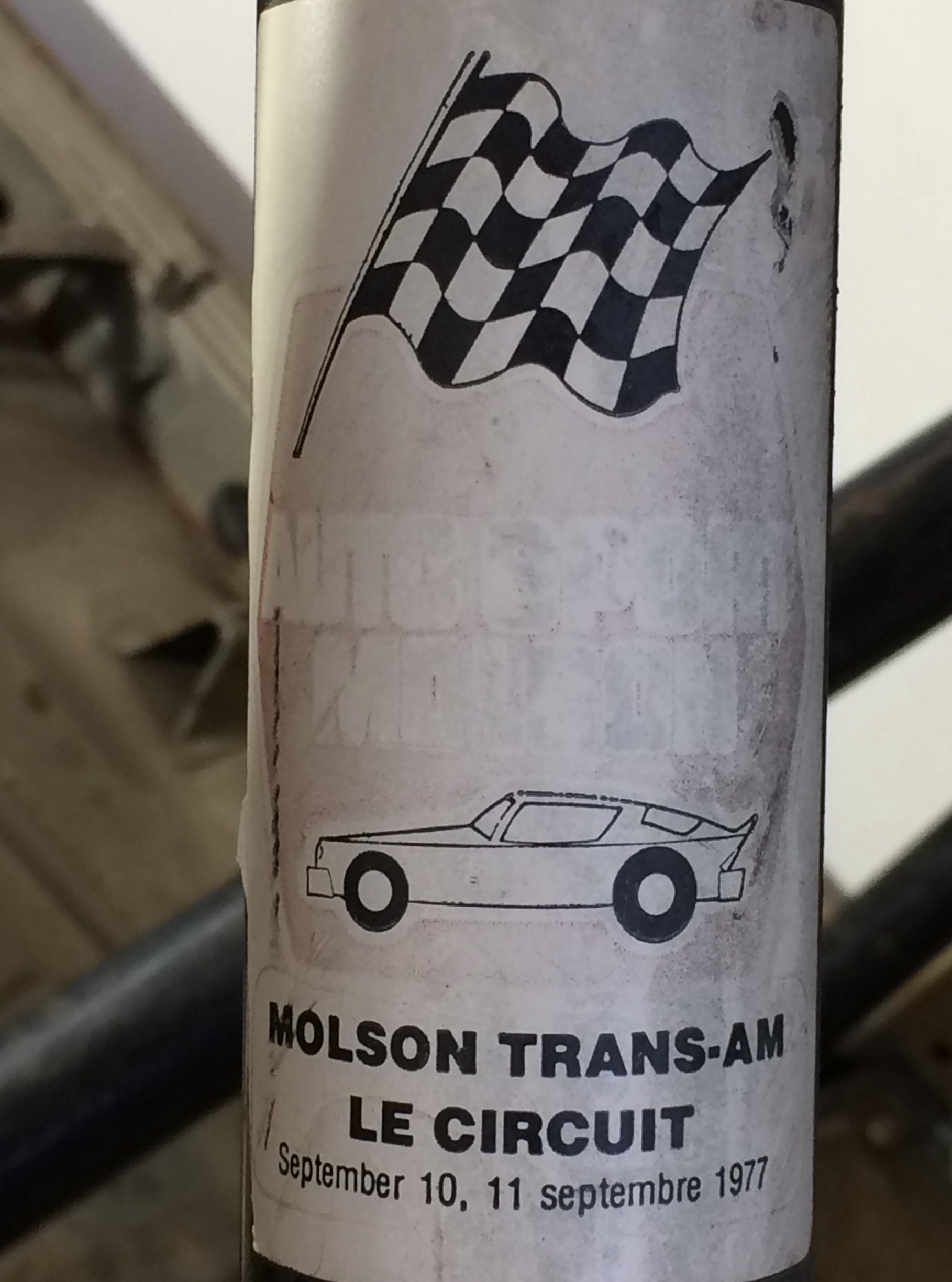

I forgot to mention this – made by Canadian Stock Car for the original Honda /Goodrich series.

Boy , oh boy Randy , that roll bar looks like it was made to fit !!!
I'll have to get my butt in gear and look for some steel for the backing plates .

If it were not for Bruce This nice roll bar would be elsewhere

I was out in the ‘race shop’ ( ok , ok garage !! ) the other day and within about 10 seconds I saw some sheet metal that I’m sure will work for both the roll bar
mounting pads backing plates and the jacking points .... it was sitting right by
the side door - we walked by it several times ... it was kismet !!
One piece is 4-1/2” x 23-1/2” x 1/8”
A second piece is 4” x 32” x 1/8” .
They are leftovers from a job I did to make up some custom mounting brackets
for an after-market rear sway bar for an ’84 CRX race car . I think that I still
have some of them around ... hey , ya always need spares , especially
when racing !!
I also have a piece 6” x 32” x 3/16” . It would be more difficult to cold bend , but not impossible .
Not sure how thick the jacking points are ... yours look a tad modified from
stock compliments of Mr Rust !!

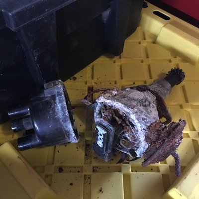

As far as the restoration goes not much is happening. But my shed roof gave out and i am having to throw out parts due to rust and plastic bits that got frozen in water and cracked. All the plastic over the inner wheel well covers and the trays along the side of the seats are trash along with the seat belt assemblies. It’s not the end of the world as i can source the seat belts from a newer Honda

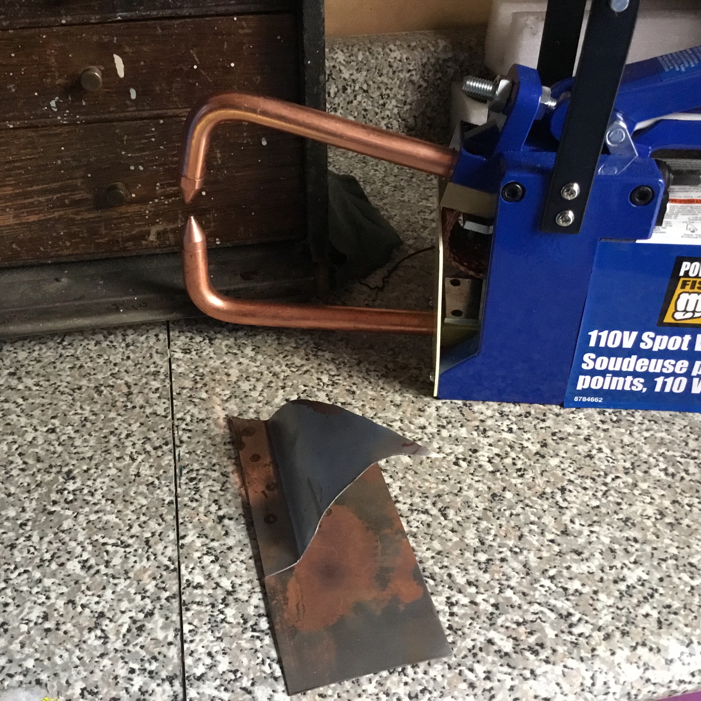

I picked up a spot welder to help me along with making the inner and outer rocker panels as well as many other areas it will come in handy.

that distributor looks completely knackered.

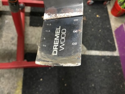

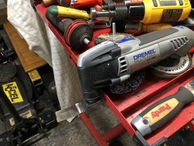

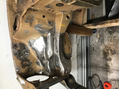

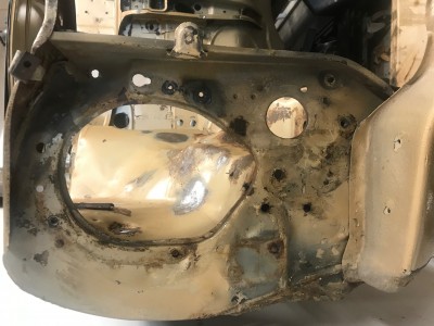

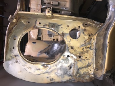

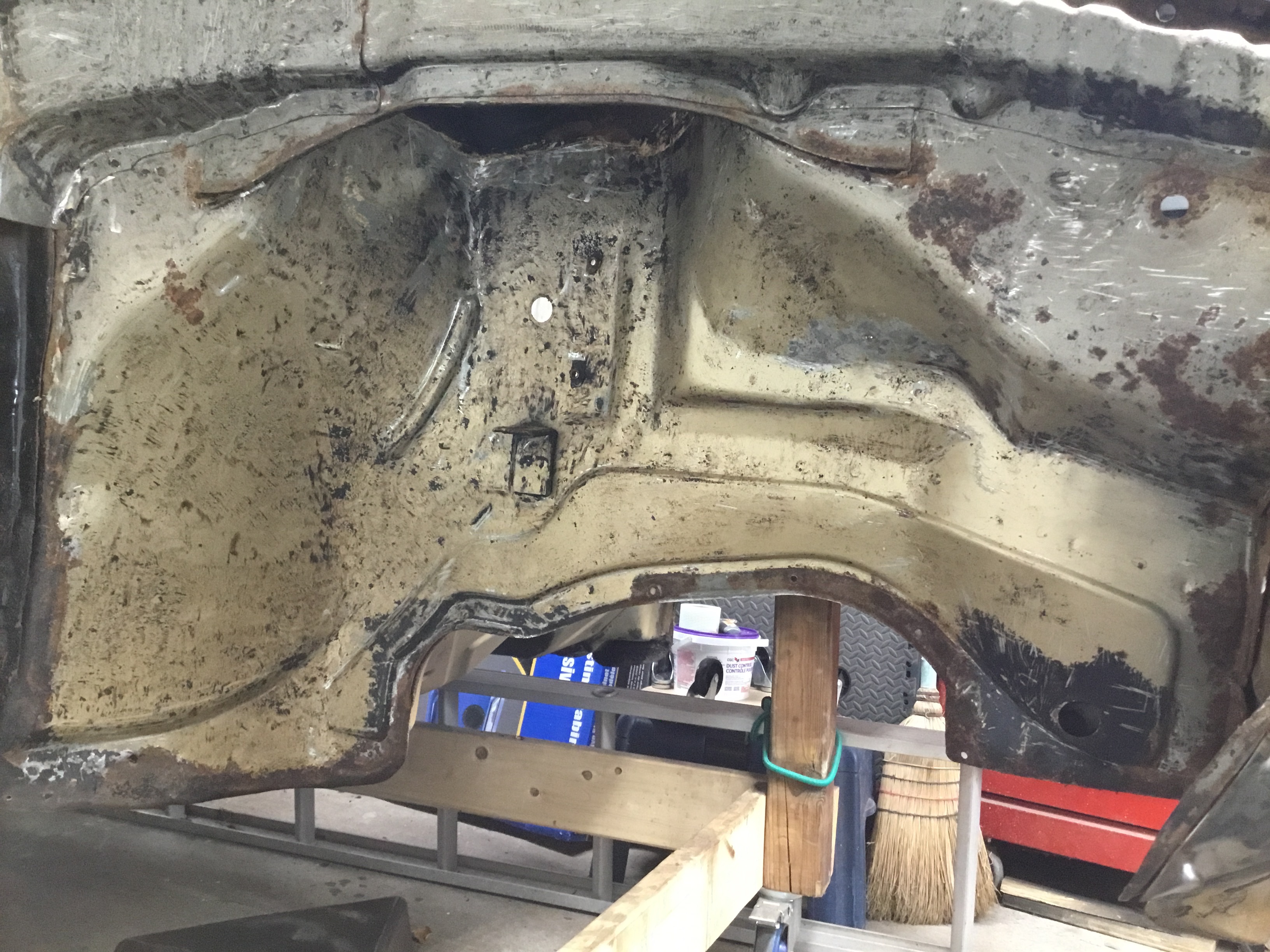

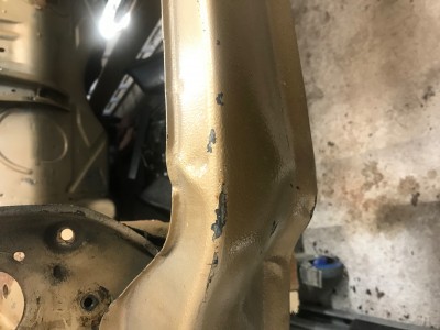

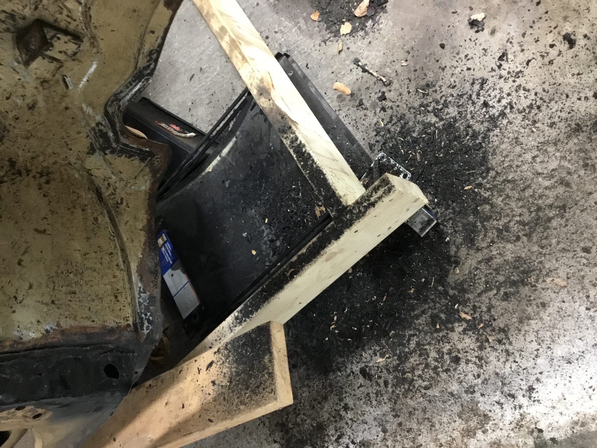

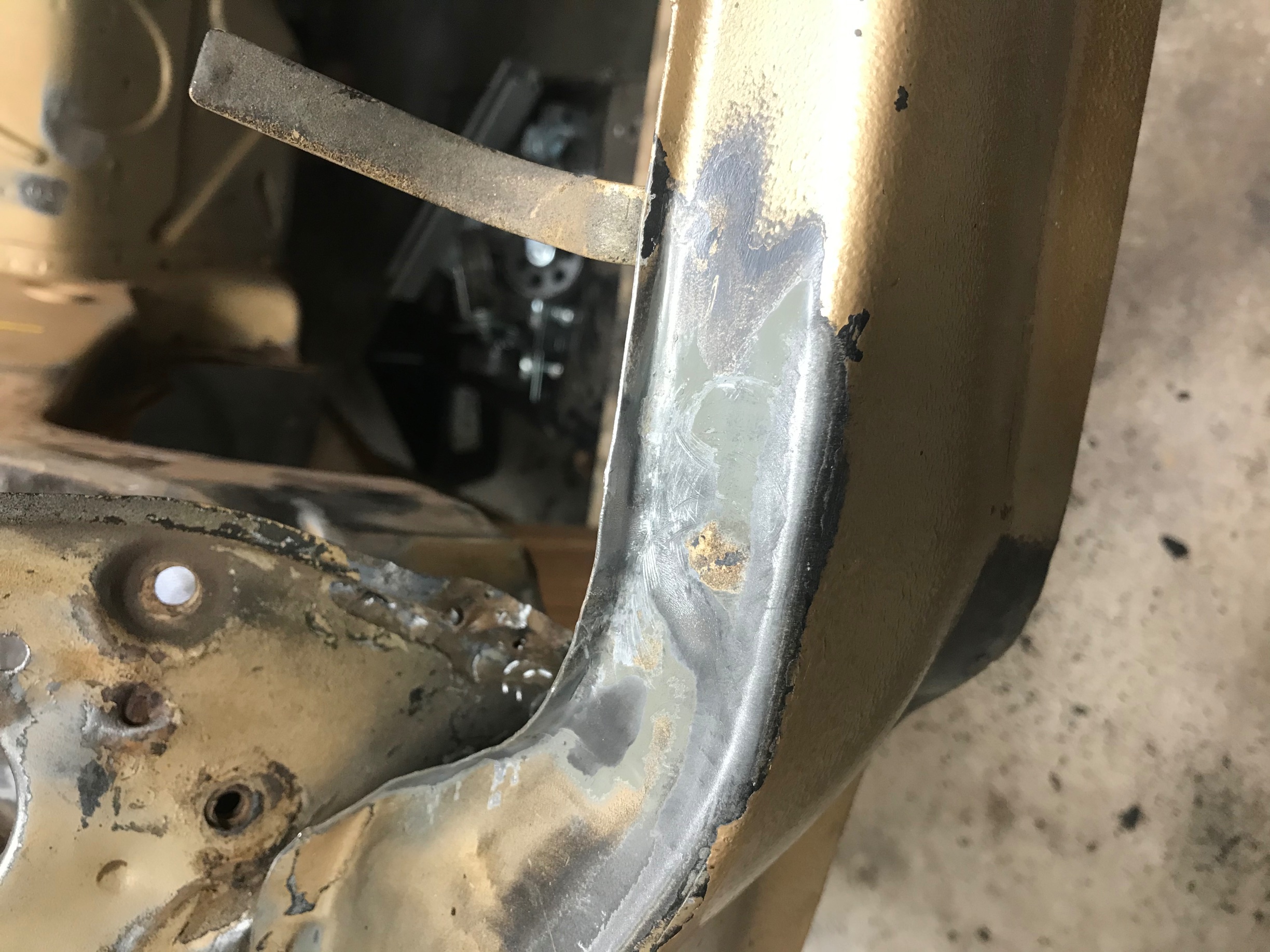

I have stripped the engine bay an removed the rusted out battery tray. Using the hammer attachment on my air chisel I was able to fix up a lot of the body damage on the passenger side including the lower valance. I was cleaning up my workshop in the basement and was about to throw out a worn out saw blade for my Dremel Oscillating Saw. Then I realized how handy it would be if I ground down the end like a wood chisel to remove the dried out under coating. I realized tonight I knocked of the rest of the wheel well in the fraction of time it took me to do it manually in my condition. The only thing I will change is to round off the corners. It takes the under coating off too easily, and makes it a snap for seam sealer. I even used the side of the blade and it gets up to the seam in the strut tower so easy without any discomfort for my neck.
