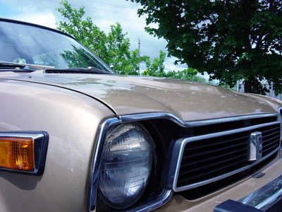

Car was purchased in July 2002 from Cobourg Honda in Ontario. It had 134,000 original kilometers. Gold exterior, AM/FM radio with 2 door mounted speakers (looks like dealer installed when new). Purchased by dealer from the original "elderly" owner in 1996 for display in their showroom. Car was repainted in 1997 in original gold color in base coat clear coat. The interior is very clean with all original vinyl and carpet in excellent condition.
It was 3 years in the dealers showroom.
Took me about 1 week and $95.00 to get it certified. Parts I had laying around including 2 drive shafts, 1 upper strut bearing, 1 tie rod end, front strut and lower ball joint. New parts included 2 rotors, pads and tires (the tires witch I stole from my restoration project car :)
Its a great looking original First Generation Civic considering it is from rusty old Ontario.
