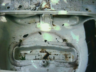

Top of pagePrevious messageNext messageBottom of pageLink to this message   By Travis (24.4.254.128) on Monday, April 30, 2001 - 02:49 pm:
Here are a few pictures of the project so far. As of being stripped.
inside
rear
trunk area
batter tray
5,dash and firewall
engine compartment
rear shock towers
I know boaring.. but hay, I gotta share.
