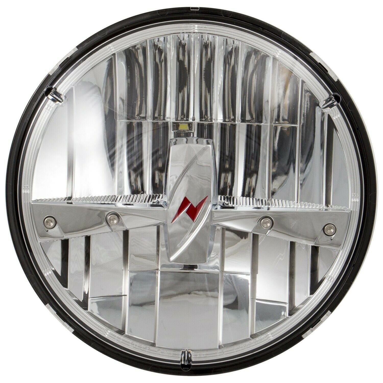

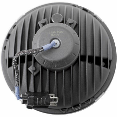

I've been converting all my bulbs over to LED and I'm switching out the 7" front headlights with a set of Anzo 7" universal replacement headlights. I've seen a few resto mod classic cars with them fitted and they look great. They're manufactured in Taiwan using high grade Philips LEDs. They fit any standard 7" headlight housing and when I checked using the compatibility tool it said they would fit the 78 Civic. They're a bit pricey though, at A$550+ including GST and postage... ouch... but they'll really look good on the front of my car IMO. I also have some 5" mini spotlight I'm considering mounting on the front bumper. They might detract from the Anzos so I might leave them off.

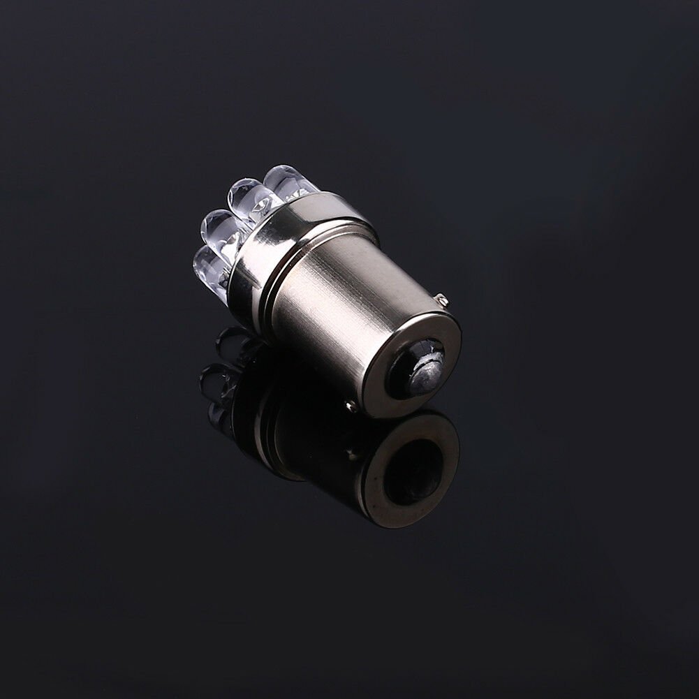

I replaced all my bulbs with LED replacements today. I bought these front parker LED 'globes' that have little lenses on them that direct most of the light forward. They're a little bright and make the front parker lights shine like low powered headlights. I love them! I put some photos below. I also ordered some Philips 'Vision' LED-type brake and tail light globes. They only emit red band light, that way they can concentrate all their energy in the specific area of the light spectrum that the red lens allows to pass through.

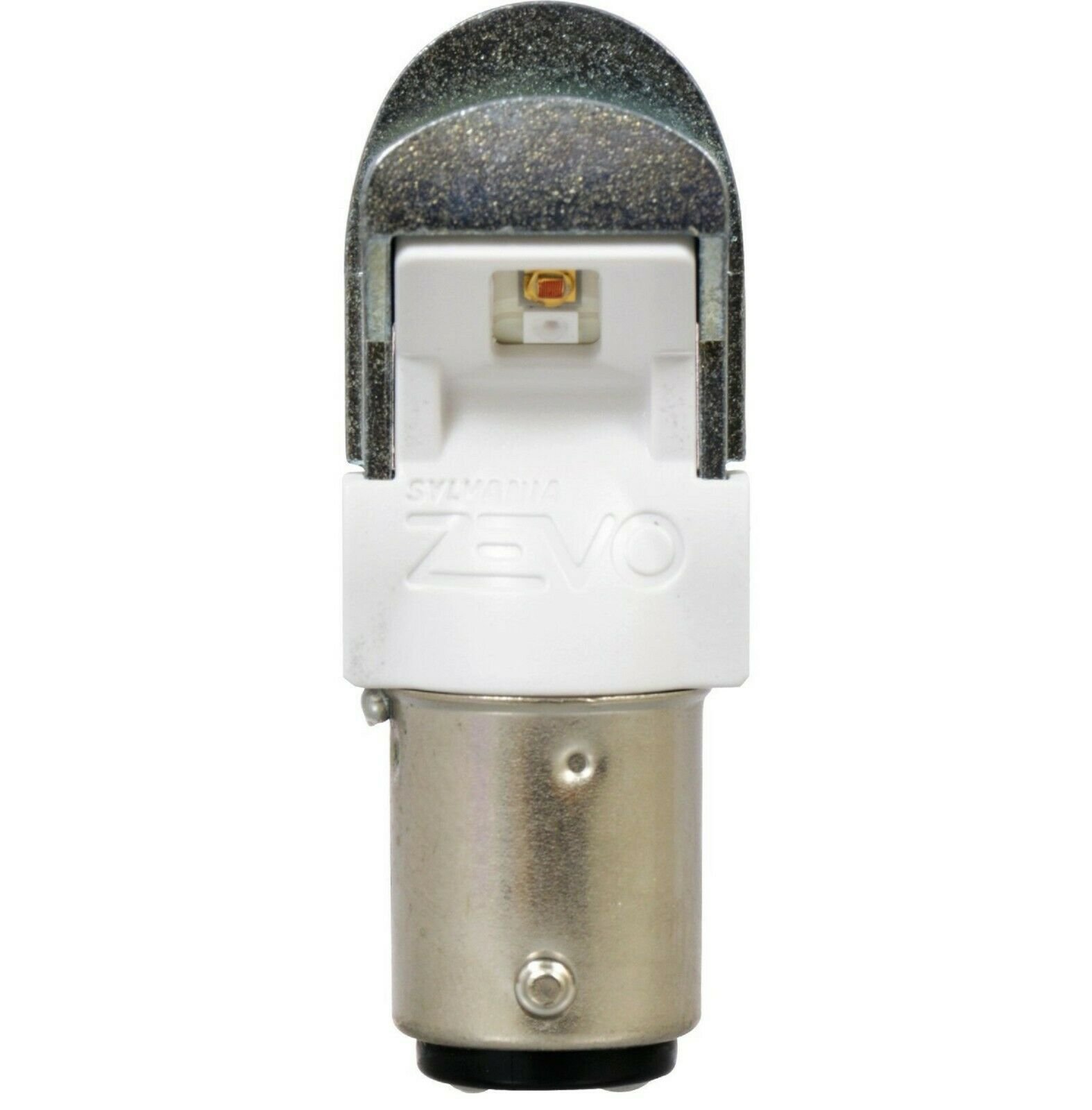

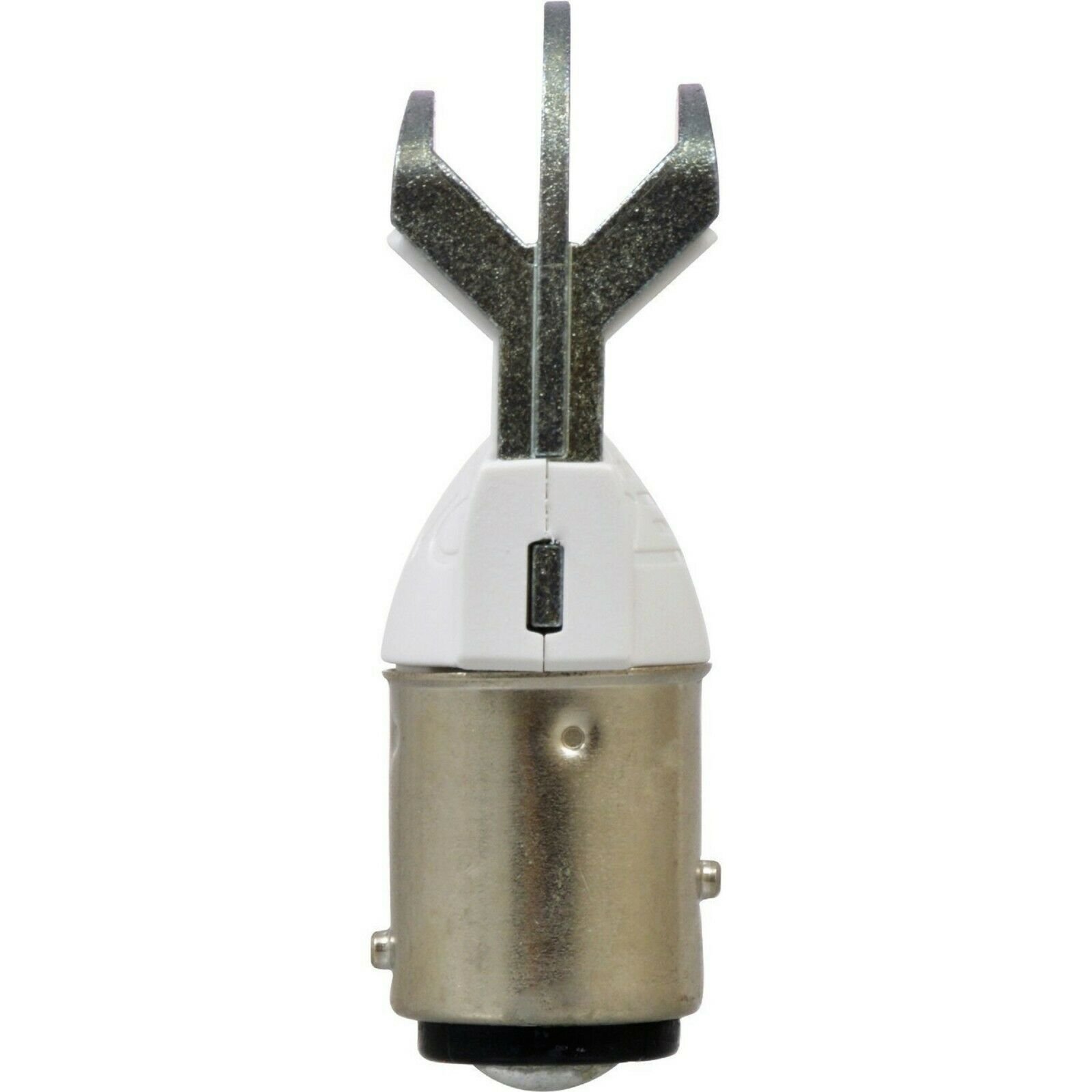

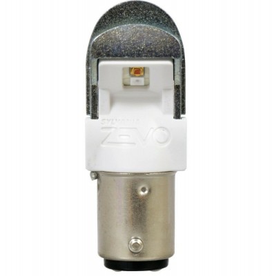

Also, those flashers are supposedly rated all the way up to 20 amps. Technically speaking they should operate with a mixture of globes, both LED and incandescent. All my research pointed me towards the Sylvania and Philips retro-fit as the only choice for brake/tail lights. I went with the Zevo range from Sylvania. You can buy them in red, amber and white. A brake or indicator lense is essentially a filter, by using an LED that is designed to emit light the exact colour as the lense means it shines brighter and uses less power. I believe the brake/tail LED replacement draws 1.7 watts and shines brighter than a 21 watt incandescent. These 'globes' are designed with the LEDs pointing back/down at an angle towards the reflector so there are no hot spots like a bare globe produces. They have a heat sink which is important for an LED brake-light that can be on for long periods of time (like when you're stuck in traffic). I bought the red and amber sets for my rear brake/indicator housing. Also, I read somewhere that the difference in the response time for the person following someone with LED brake lights, as opposed to incandescent globes is about 18 feet. The reason being that an LED emits light immediately, whereas an incandescent globe takes time to heat up before it lights up. 18 feet is a big safety gain. LED brake/tail lights should be made mandatory IMO.
