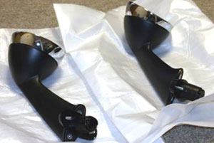

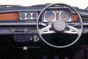

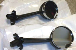

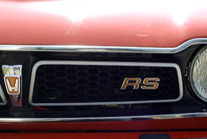

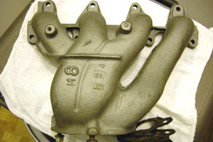

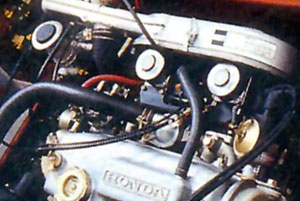

Dubbed Road Sailing, it was a more performance oriented civic opposed to the standard economy-boxes we all know. It was released with an 1170cc EB1 motor pumping out 70hp compared to the 50hp of the standard model. Engine modifications included twin Keihin carburetors, a freer flowing exhaust manifold, longer duration camshaft (15 degrees), domed pistons (bumped compression up to 8.6:1), and strengthened crank bearings. Handling was increased with a set of stiffer springs (30%), shorter stiffer struts and 13″ wheels wrapped in 155-80-13 tires. The wheels were black with polished lips and had a red “H” center cap- this is where the red Honda “H” started. Besides the RS badge on the front grill other exterior options included flared fenders, fender mounted rear view mirrors, and a slightly different bumper assembly. The RS’s were only released in warm red/orange paint schemes. The black vinyl interior included a wooden steering wheel and shift knob, center console, grab handles, a mechanical tachometer graded to 7k rpm, and a center auxiliary pod with fuel/temp gauges and an air vent. The US gauge pods merely had gauges for fuel and temp.

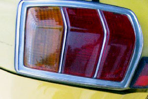

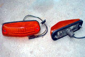

I appreciate the cleaner look of the RS without rear side marker lights.
However, I’m curious about the distinct designs of the front bumper lights, both under and on top.
Does anyone know what the round holes under the bumper are for? I’ve never noticed them before.
